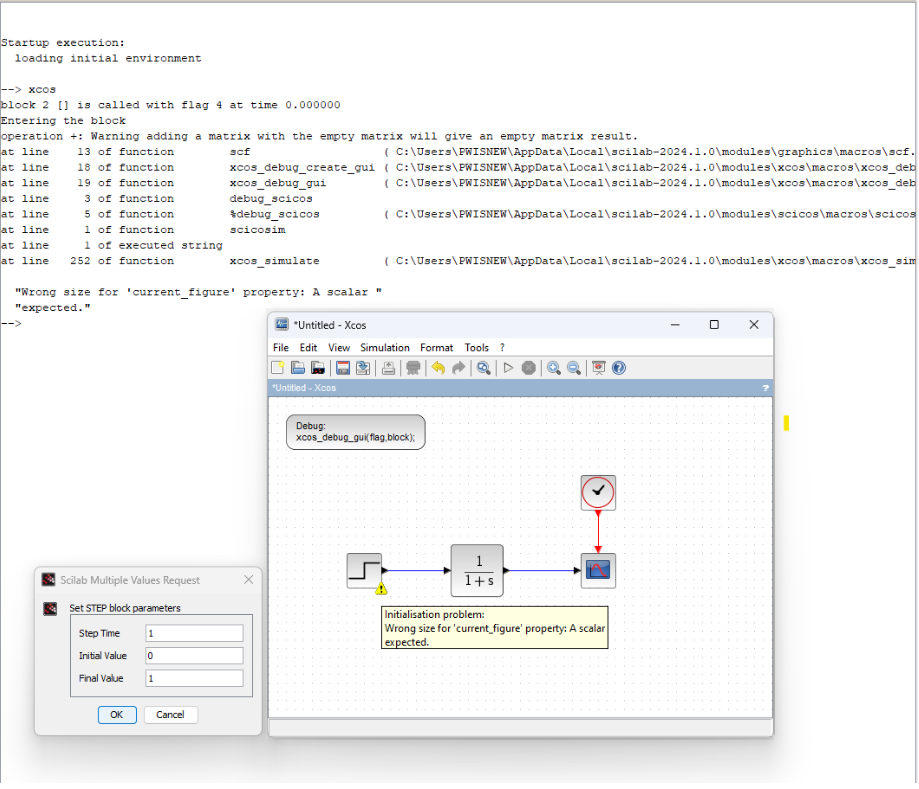

I added a Debug: xcos_debug_gui(flag,block) to a simple graphic, just to see if it would catch an error and stop before closing the program. Here is the result:
I am using the default parameters in each of the blocks. I am not sure why it is giving this error. By the way, this is Scilab 2024. The 2025 version was giving the same error, but when I went to capture it and re-ran the program, it just completely crashed and the Debug block would not work again for Scilab 2025.

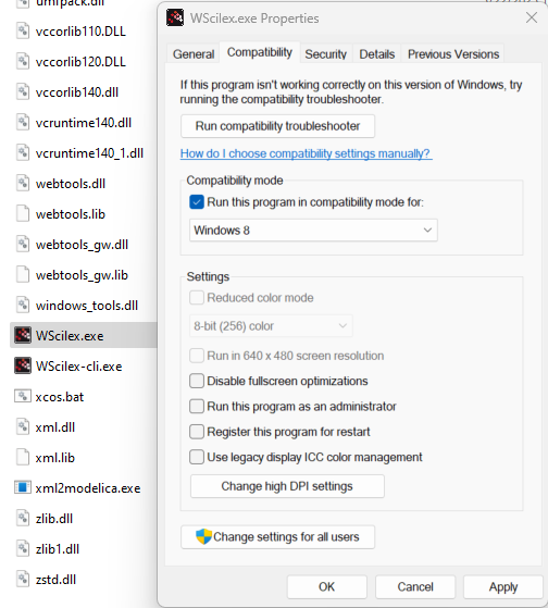

He suggested that I try changing & running the WScilex.exe in compatibility mode (Properties>Compatibility). So I changed it to Windows 8, which was the latest Windows version available):
This significantly improved being able to open and run XCOS and run the demos, but did not completely eliminate the crashing/closing of Scilab/XCOS. I was able to open XCOS and build a simple diagram and run it. I was able to add to the diagram and change parameters, and it continued to run without crashing. I could change the transfer function parameters, add different sources, etc., and it would continue to work.
Then I tried running the demos. I was able to open and run about 5 or 6 of them before it would crash. Sometimes I would change the a parameter value in the demos and re-run it before opening the next demo to run. But eventually, Scilab/Xcos would crash. One particular demo that I could get it to crash regularly was the Xcos>Control Systems>Water Tank demo. I would open and run it, change the controller tuning, and run it. Change the controller setpoint and run it. I would keep doing this, but eventually after 8 to 12 runs, Scilabl/Xcos would crash.
