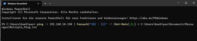

Please run the ping command in Powershell instead of DOS cmd to see if the encoding problem remains.
i did what you asked fore and did not touched the file, but still with mgetl not good
Multiple_Ping.txt (5.9 KB)
[quote=“mottelet, post:3, topic:988”]
U+0081 is Latin-1, its on windows 11, i tried to add -Encoding UTF8 but it gives me an error
