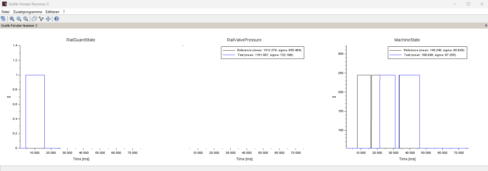

Hello,
(using 2024.0.0 on Windows 11)
I want to plot a number of plots in one graphic window. I used subplot for this. Furthermore I want a funktion that only give you one plot, but you can add annother one to the same graphic window. That all works in general, but it looks like this:
So the subplots overwirting parts of the previous ones, although they are not overlaping.
This is my code:

refData = dataReadFromFile("FlowControl_Reference_.m")
rawData = dataReadFromFile("FlowControl_Test_.m")

plotData(refData(1), refData(3), "Reference", rawData(3), "Test", 1, %T, [1,1,1])
plotData(refData(1), refData(2), "Reference", rawData(2), "Test", 2, %T, [1,2,1])
plotData(refData(1), refData(4), "Reference", rawData(4), "Test", 2, %F, [1,2,2])
plotData(refData(1), refData(5), "Reference", rawData(5), "Test", 3, %T, [1,3,1])
plotData(refData(1), refData(6), "Reference", rawData(6), "Test", 3, %F, [1,3,2])
plotData(refData(1), refData(7), "Reference", rawData(7), "Test", 3, %F, [1,3,3])

I would give you the full file but I’m not authorised to do that.
Can someone help me with this?
Thank you
