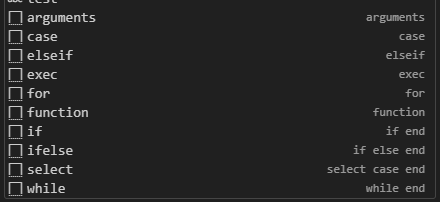

About the autocompletion for the word function, you can autocomplete using the keyword (first row in the next screenshot) or the snippet that will create the function structure (the last row in the next screenshot).
In your case, you had autocomplete using the snippet.

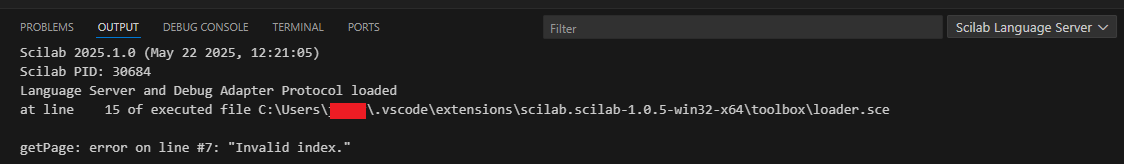

I have used VSCode for hours many times and gets stuck here (wasn’t able to post screenshot the first time :sweat_smile:):
Here are the logs for the Language Server:
Scilab 2025.1.0 (May 22 2025, 12:21:05)
Scilab PID: 29336
Language Server and Debug Adapter Protocol loaded
at line 15 of executed file C:\Users\name\.vscode\extensions\scilab.scilab-1.0.5-win32-x64\toolbox\loader.sce
getPage: error on line #7: “Invalid index.”

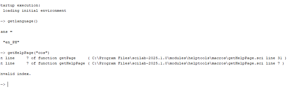

Can you open Scilab (without VSCode) and execute those commands?
getlanguage()
getHelpPage("cos")
Here’s the result:
Thanks for the logs, I’ve reproduced your error and opened an issue: inline doc fails for non existing language documentation (#17479) · Issues · scilab / scilab · GitLab
What you can do for now is to use en_USas the default language in Scilab.
To do that, execute this command:setdefaultlanguage("en_US")
Let me know if it works :slight_smile:
