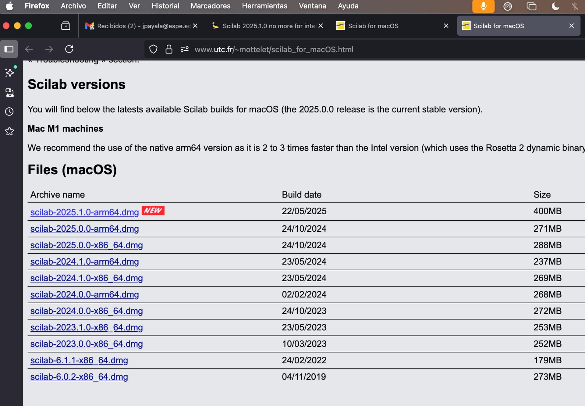

I have packaged a non-official scilab-2025.1.0 bundle for Intel that you will find on my Scilab page at https://www.utc.fr/~mottelet/scilab_for_macOS.html. Be warned that the new GUI browser widget is not working, so please consider this build as non official (it is not provided on the official Scilab site www.scilab.org).

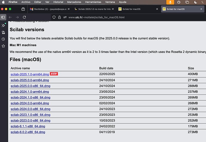

Hello, Thank you, but sorry i can’t find the scilab-2025.1.0 with the link that you give me.
In the page, look for scilab-2025.1.0-x86_64.dmg
Thank you, I appreciate you
I think that a refresh of your browser window should fix the problem
