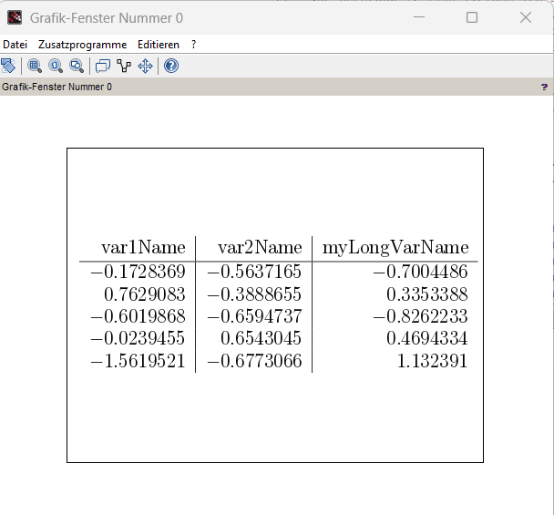

Can you test the following code:
function str = table2latex(t)
[_,m] = size(t);
head = strcat(t.props.VariableNames," & ") + " \\ "
data = strcat(strcat(string(t)," & ","c")," \\ ")
str = [ sprintf("\\begin{tabular}{%s}",strcat("r"(ones(1,m)),"|"))
head; "\hline"; data; "\end{tabular}" ];
str = strcat(str," ");
endfunction
after defining the function table2latex, the Scilab function prettyprint should work for tables (default LateX mode):
t = table(rand(5,3,"normal"), ...
"VariableNames",["var1Name","var2Name","myLongVarName"])
pp = prettyprint(t)
titlepage(pp)
gce().interpreter = "latex"
zhat works for the example well, andhas some box arround, but with my exapmle not quite. but i will look further when i have time
The box is made by titlepage, use the latex code as you want…

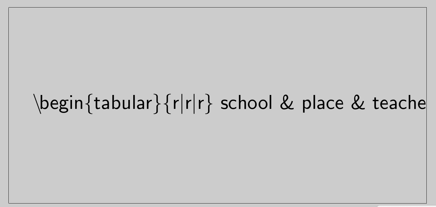

doesn’t quite work on every occasion, must look why. maybe because my table are full in string or struct2table is not quite the same as table?

Do you have an example ?
WI.school=[“BHF”,“FFHS”,“FHNW”,“HEIG-VD”,“HSLU”,“SUPSI”,“OST”,“ZHAW”];
WI.place=[“Quellgasse 21 2501 Biel”,“Schinerstrasse 18 3900 Brig”,“Bahnhofstrasse 6 5210 Windisch”,“Route de Cheseaux 1, 1400 Yverdon-les-Bains”,“Technikumstrasse 21 6048 Horw”,“Via la Santa 1 6962 Lugano-Viganello”,“Rosenbergstrasse 59 9000 St.Gallen”,“Technikumstrasse 9 8400 Winterthur”];
WI.teacher=[“Prof. Dr. Stefan Grösser”,“CAO Simon Ruff”,“Prof. Jörg Lageman”,“Prof. Jean-Michel Schulz”,“Prof. Thomas Schwank”,“Prof. Paolo Pedrazzoli”,“Prof. Sonderegger Urs”,“Prof. Dr. Richard Bödi”];
Table_WI=struct2table(WI);
t=table2latex(Table_WI)
pp = prettyprint(t)
titlepage(pp)
gce().interpreter = “latex”
this is my example.
m.f.g. Pascal
i have seen, that discourse mismatches the “” scilab string function.
Test.sci (692 Bytes)
Please use code blocks, otherwise this is very complicated to copy-paste the code you are posting (see https://scilab.discourse.group/t/welcome-to-the-scilab-discourse-forum).
Likely, you didn’t understand the different mechanisms in place: you don’t have to call yourself table2latex (it is automatically called by prettyprint). So the whole code of your example should be:
